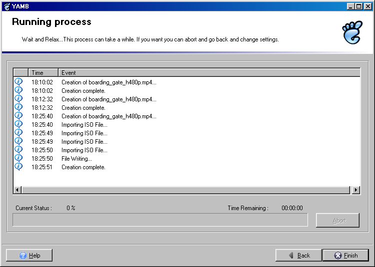

Ok. We are close. Yamb v2.0.0.8 is up and running, and even took my .MOV trailer and
displayed its content specs and things. Looks nice. However, there is a problem!
It can't find MP4box -- what the.. -- anyway. I guess it doesn't come complete, and you
have to do a little extra work, for it! Oh well. Let me see if I have this file somewhere on
my HDD. Doesn't say where to put it, but my guess is that it has to go in the folder that
yamb is in.
Will be right back..
-vhelp 4579 -
[SOLVED] -- Success!! -- only took 3hrs 20mins
Platform: WINDOWS 98 Gold version
I found a copy here, the file name is: msvcr80.zip
--> http://www.dll-files.com/dllindex/download.php?msvcr80download0VMhUIbIiV
And here's the evidense..
-vhelp 4581 -
Still, you'd better update your bookmarks:
http://esby.free.fr/CelticDruid/mirror/mpeg4iptools/
http://yamb.unite-video.com/download.html
http://kurtnoise.free.fr/Yamb/
And keep having fun!
Thanks for the tips, Midzuki, everyone, too.
You know how you've been searching, and searching, for a long time, and then when it
happens, you don't believe it ?? Yeah. That's kind of how I feel right about now. Anyway.
I have other problems. L.O.L., you see, I thought that this tool (any of them, once I got
them to work, that is) would demux or transcode them into an *new* AVI container, (much
like I could do with VLC app) or one that I can open in virtualdub for further editing/filter/
re-encoding, etc. But, to my surprise, that does not seem the case.
However, I am able to write an AVS script and using the DirectShowSource() method to
open them and then frameserve them into virtualdub for further processing. So not all
is lost after all
Maybe there is a command-line tool version to simply demux them and/or allow the .mov
Apple's (AVC/H264) trailers to be in a new avi container. No, I don't like or use MKV.
(matroska container) version. Anyway. I'm just thinking out loud now
PS: I hope you can see the image. I couldn't, on my end, and had to edit it like three times.
Finally, I had to right-click the blank image and select [reload] option, and then it displayed,
weard, Opera v9.24 -- I don't know.
I'm going to try a couple more movie trailers that I D/L'ed previously, and see how they come
out with Yamb v2.0.0.8 and if they come out ok (using the above scenario I mentioned) I
might start work in yet another project, where I had this idea about snipping Apple's movie
trailers with the aid of a utility I was thinking about writing. Then, later, I would run them
all through Yamb and AVS script and do what I was visioning on about. Ahh, its just a stupid
idea anyway.
Thanks to everyone for putting up with me in my trials.
-vhelp 4582 -

So far, I am loving this routine. Its fairly quick. But, I also have a stuborness directly using
AVIsynth scripts under certain cercumstances. I just gotta do everything in virtualdub. But
anyway. After I transcode the Apple (.mov) trailers using Yamb v2.0.0.8 I quickly create a
pseudo avi source file and then open it in virtualdub for quick WYSIWYG processes. And if
need be, I can always do the direct avisynth thing afterwards anyway. You know how it goes.
-vhelp 4585 -

yeah, only this time, its now on my XP system, and all the above steps are NOT workingVHELP and his obsession over Win98 strikes again LOL
Actually, the methods discussed ealier above are no longer working on my WIN98 computer.
So, now both systems can't process apples .mov trailers anymore. However, I found another
method, and it works, and the finishing tool (after the movies AVC/VC-1/h264 is transcoded
out of the .mov continer) can be used DGAVCindex, flawlessly.. so far.
-vhelp 4724
